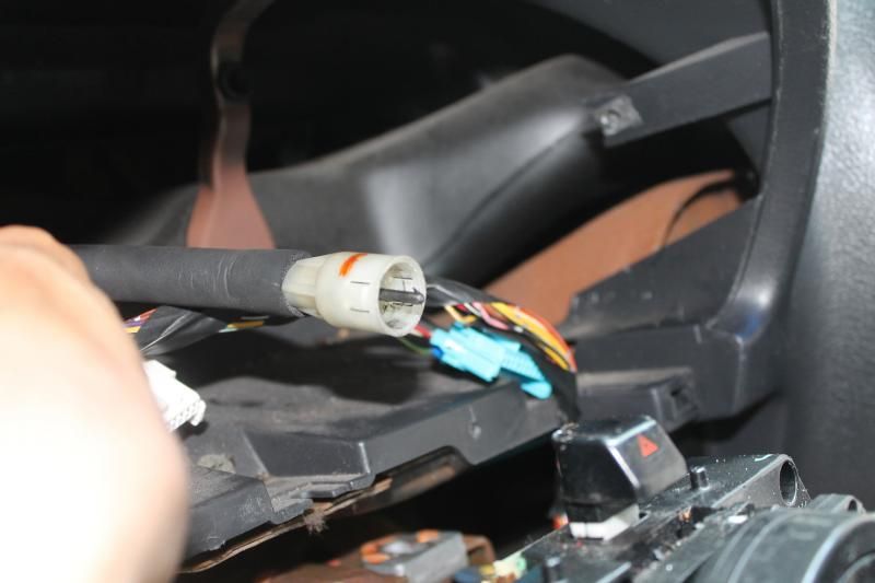

Here are some pictures during my installation~ I'd like to be a contributor to this wonderful site too!:)
dne'
Once the cluster is unfastened from its hookups, I found it easiest to take it out through the steering wheel opening. I did have to drop the steering column by taking out the two bolts that hold it up. Of course the covering does have to come off~ you don't get off that easy!
after wrestling with the speedometer cable, I found that a gentle squeeze and pull on the cable where it is held onto the cluster~ it comes off.
To get more leeway from the speedometer cable, you need to go inside the engine compartment~ it will make sense when you look where the Speedometer cable is.

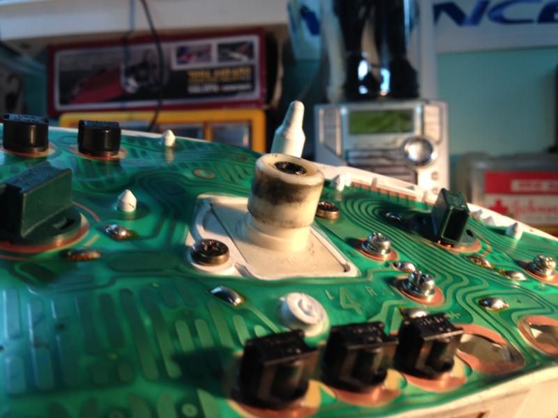

Thanks for the assist :) Hopefully I can provide a good explanation since I did not actually get to see the back of the cluster myself (yet).
This is what the needle looks like when the car is not moving (not the same care but you get the picture): http://www.allfordmustangs.com/foru...hments/5-0l-tech/38296d1200691032-fox-body-speedometer-needle-stop-dsci0168.jpg
The mechanic said that the speedometer cable has a pin thing in it that isn't completely round that turns the piece where it connects inside the instrument cluster. In this case, the cable pin thing is almost completely rounded and so is the slot inside the cluster. There are a lot of metal shavings / dust in that area.
Later this week I will take it out and take a good picture.
