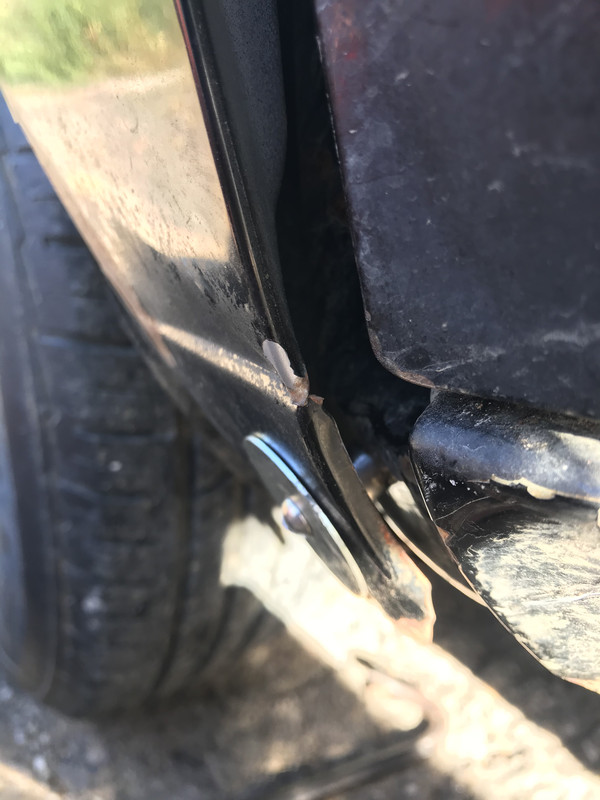

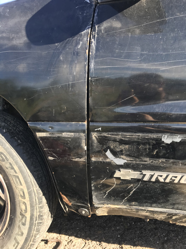

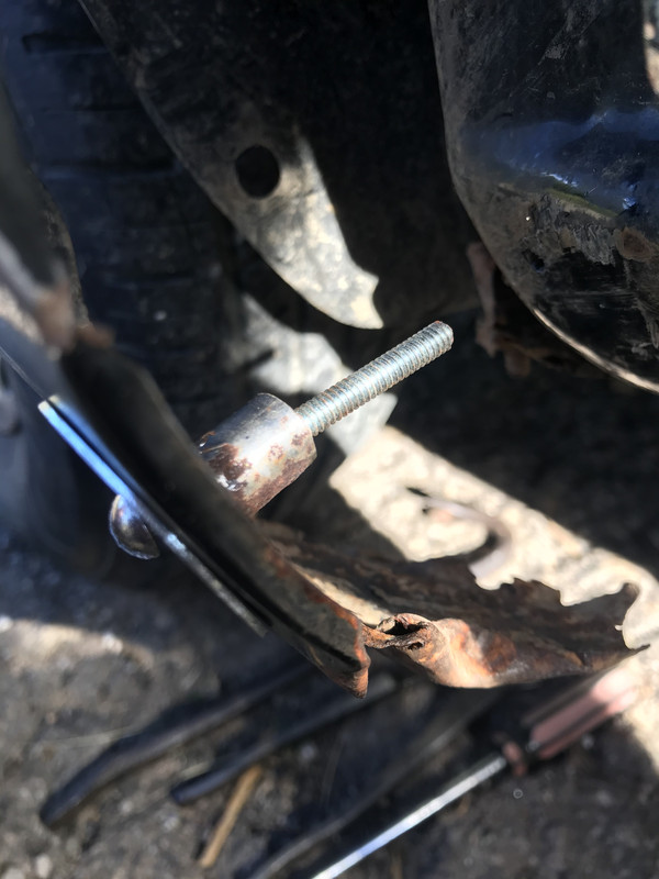

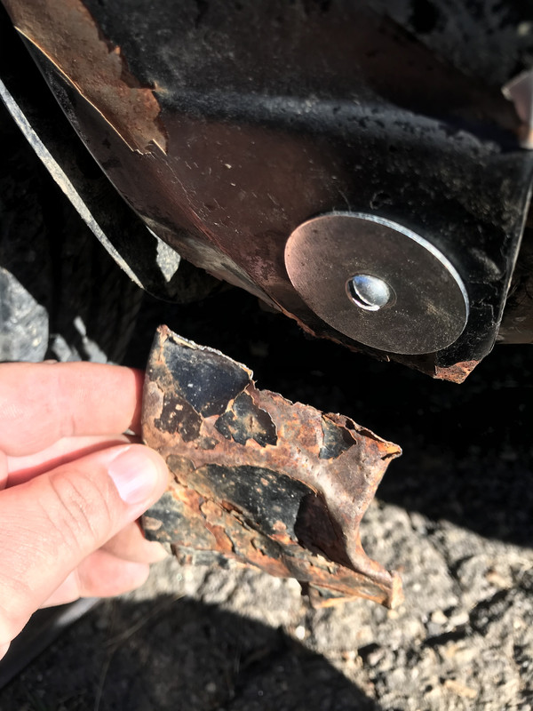

While I wait for the caliper, thermostat, radiator cap, and cv axel from rockauto, I am tinkering on some of the other things that are next on the repair list.
I moved it in the yard last night and barely nipped a tire that is laying there, and it bent the fender even further.
So with a bolt, fender washers, a cut off cheap socket, and a lock nut. I bolted through the good metal of both the fender and rocker.
Broke off the bottom that was hanging by a thread.
A little black spray paint and it'll hardly be noticed.
Not great door gap, but the door opens without catching and the fender won't catch everything or vibrate when driving.
A few zipties keeps the plastic inner fender in place - what is that called? And what are the plastic body pins/keepers called?
