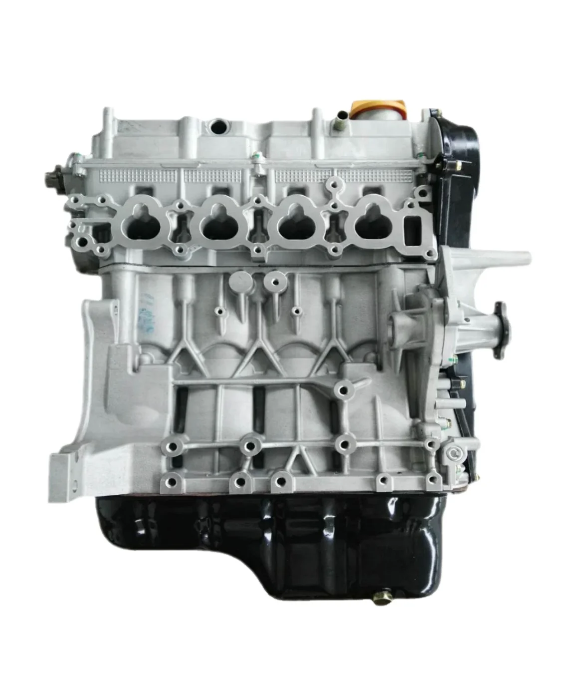

with decent 1.6L engines getting dear and the Samurai tribe after them too, this becomes interesting:
big discussion in an italian forum im in if these are valid...
any experience here?
#2 ·
No personal experience, but, I tend to view anything sold through Alibaba with a great deal of scepticism.
Let's start with the description, what are you getting?
Generally speaking, and it's not 100% correct, the G16a is considered to be an 8v engine and the G16b a 16v engine, they've lumped the two together - that gives me a very bad feeling. Now, the reason I say it's not 100% correct, is I've personally seen 16v G16a engines, in Suzukis, and I know the vehicle left the factory with that engine.
They also list it as fitting the Jimny, which never shipped with a 1.6 engine - more "bad feeling" - I'm now wondering if the seller actually knows what they are selling, something which I suspect to be quite prevalent on Alibaba - it's a marketplace where Chinese vendors sell products which they may or may not have manufactured themselves - take for example the knockoff air lockers, several vendors all selling what I believe is the same product manufactured by a Chinese company called HF (www.hf4x4.cn)
What's in the picture appears to be a 16v engine, and as far as I can tell, it's not the OBDII version (no crank position sensor) - I'd be happier if I saw specifications, bore x stroke, valve train details, that sort of stuff - the price isn't bad, it's probably going to cost me more to ship, and I'm not willing to take chance that when it gets here it's not what I'm expecting.
...the price isn't bad, it's probably going to cost me more to ship, and I'm not willing to take chance that when it gets here it's not what I'm expecting.

You have no guarantee, in fact, I'm almost certain the engine on Alibaba is NOT coming from Changan.
so between a used G16 like this at 1500$ and the allibaba at 770$, youd still take the used one form a breaker?
mmm.... thats the question...
That's actually not how I saw the question ...
Anyway - yes - I'd take the one from the breaker, here, I can see what I'm buying before I put my money down, I have a 90 day warranty and can opt for a replacement or a refund - and I don't have to concern myself about quality of the product or whether there will be a problem with replacement parts in the long term.

The link above will take you to the Alibaba page for the vendor selling that particular product, as you can see, they were established in 2021, but have managed to be a "gold supplier" for three years...
Below you'll find a list of suppliers of similar products, all from page one of a search on Alibaba for "G16 engine"
Ziptek (second link) have been a gold supplier for five years, were established in 2018, but have TWENTY years of experience. Be sure to click on the fourth link and look at the pictures, specifically the oil pan, kind of oddly shaped isn't it? That's because that particular engine is tipped over to fit under the seats of the Every/Carry vans, only problem is, those didn't come with a G16 - there is a version that did have the G16 (known as the APV) and those didn't have that oil pan.
Caveat Emptor - let the buyer beware - or, and this is taken straight from wikpedia - Caveat Emptor, quia ignorare non debuit quod jus alienum emit - Let a purchaser beware, for he ought not to be ignorant of the nature of the property which he is buying from another party.
The onus is on you, the purchaser, to ensure that the product is fit for the purpose you have in mind, I've dealt with enough Chinese to know that as soon as there's a "complication", they'll suddenly "stop speaking English" and do their level best to frustrate you into just giving up.
Wow…thanks for such a detailed response. And yes, even to me, a non mechanic, that oil pan in the 4th link looks quite bizarre. If nothing else, the lesson is that you really need to know what you’re doing, when purchasing something like this (or staying away from it). The price might entice those who don’t dig deep enough into this, sadly. But yes, caveat emptor is the thing to always remember.

The official Suzuki parts manuals don't show a different part number for 8/16v blocks in the 92~95 years, however, pre 1992, the part number for the block is different - this however, doesn't mean that you can't use the newer block in the older models. My manuals show the same part numbers for 8v pistons from 89~95.
#26 ·
no, pistons are markedly different, specially the valve reliefs 2 in the 8V, 4 in the 16V.
you could fit 16V pistons to the 8V block, but thats an engine out car fix
