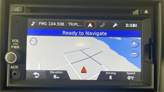

Well, another update lol. I found a piccy of my system:
Mine has a physical knob on the left for power/volume which I couldn't find online before.
Cheers
Steve
