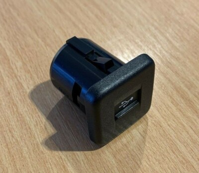

Last day of the year brings a minor repair!
The connection on my USB socket was a bit ‘hit or miss’, more than likely over the 6x years of the cars life.. the small USB tongue part had become worn…
a replacement USB socket was £60 online…
To replace….
You reacharound around the trim panels through the gap down beside the pedals…
in here…
there are two retaining lugs in the socket that are easily pressed in by hand which releases the socket that can then pull through for disconnection and replacement.. all in a 60x second job.
all is now working a-okay!
Just found this topic to late. Had the port replaced by the dealer. Unfortunately it didn't help, it seems to connect, but after half an hour the connection drops again. The cable to my phone is a new official apple cable. So I think it's the cable behind the port that's the problem. Any thoughts about that and any info about how to replace that cable?
Is your car under warranty?
No, I don't have warranty anymore, at least at the car itself.
Thats a shame You can buy a lead from a number of places and this video will give you some idea of what you have to do to gain access to the rear of the unit to replace the lead the bottom part at the socket is easy its the actual socket in the unit itself that is fiddly But someone else may know an easier way look at this video best of luck
Thanks, this is interesting. Still in doubt if it's the cable from the headunit to the port, or am I better of with a wireless transmitter as Carlin?
Sorry cant help ypu with that .What i can say is that when i purchased by vitara which was a year old had same problem as you have and had portreplaced which made no difference and ended up having cable replaced as well and have had no issues since .Does it do the same with a USB stick plugged in because if that is ok then its would seem to point to the apple lead itself also is your firmware in the unit up to date ?
My firmware is up to date. I will try a usb-stick with mp3's. Thanks for thinking with me!
To replace….
in here…
Can you please post the link you bought the usb port? Thank you!
