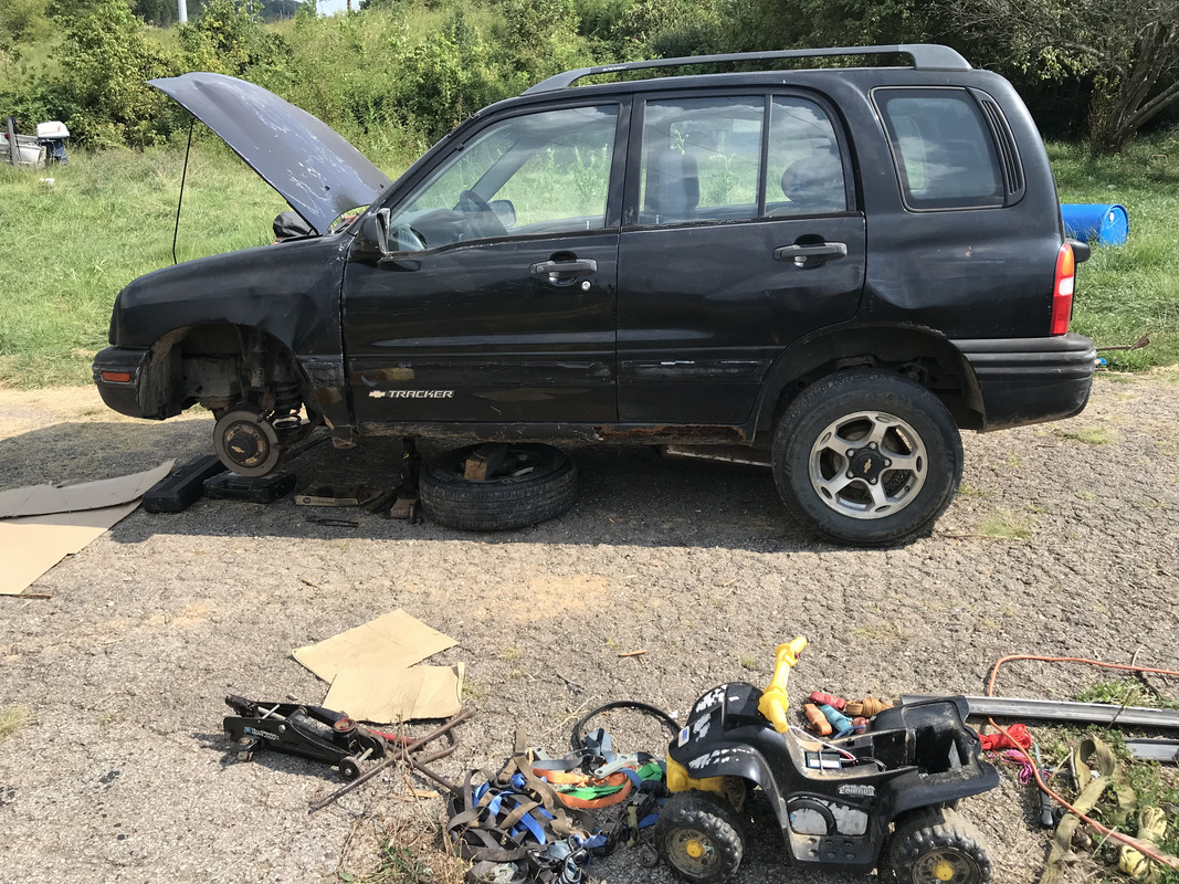

Here she is, as she sits in my driveway.
You can see, the left front tire is off, as I have a locked up caliper. Upon inspecting/removing that, I noticed the CV boots are cracked, though no debris is apparent in the grease.
I currently do not have a vehicle other than this one, so my first priority is to get it road worthy enough that I can drive it get parts/groceries/go to church.

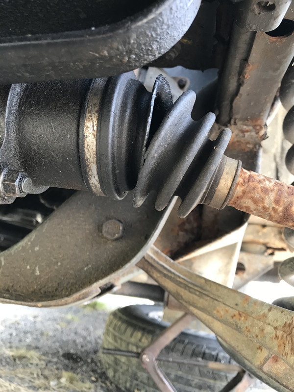

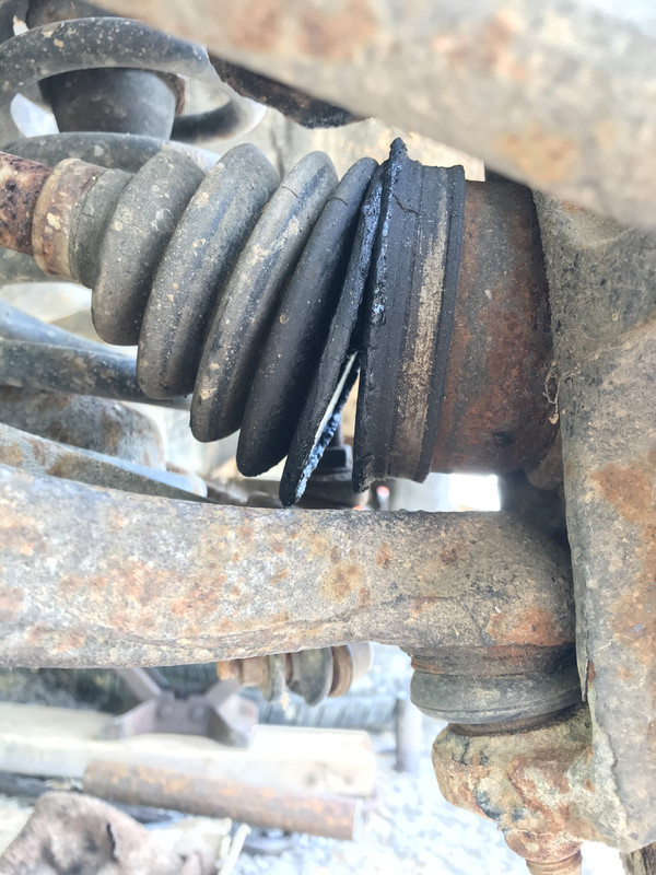

Things have went farther awry!
Me and the boy went out to look it over last night and noticed this. I've been researching it all day. I hear tell it's a bear to get apart. I cannot articulate why, because I haven't taken one apart. From what I gather I will have to take the axle out and there is a tool to get the bearings off and it's hard to come by. Some years ago, my mom paid a local mechanic (that I still know) to change the wheel bearings and he had to borrow a tool from a friend.
My father inlaw is a good mechanic and has had a Vitara, and he had this issue, he said I would have to pay someone to fix it and it cost him $500 when it happened to his. So can anyone speak to this?
#79 ·
Can anyone tell me if this is normal or synthetic fluid based on the color? Years ago my mom had a mechanic change the bearings, and I'd guess he put the cheapest oil in it he could get.

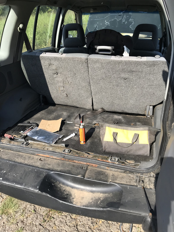

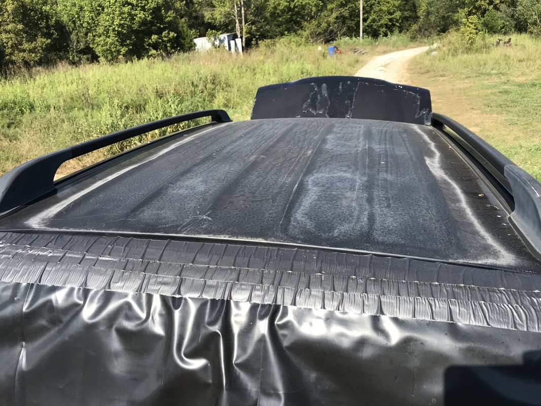

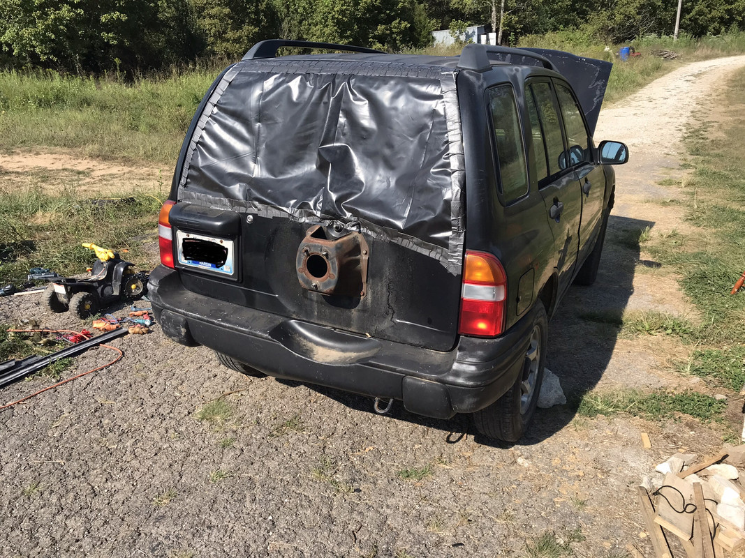

The back glass is busted out of the rear. I did this to it, I got it stuck in the yard and accidentally backed into a tree. I saw the tree, just not the low hanging limb. Not sure what my options are. Might end up getting a glass somewhere and putting it in, or maybe I'll put a piece of plexiglass in it. Or, it'd be cool if I could find/retrofit a soft back glass with a zipper into it. We'll see. For now, a good tape job has kept the interior from getting wet.
The inside of the back is not in horrible shape.
Need to get cross bars for the rack so I can haul stuff.
So much wasted space here... does anyone know of any mods that utilizes this space? I might make a place to store a chain here. I do have 5 wheels for it, and it has the keyed locking lug nut thing.

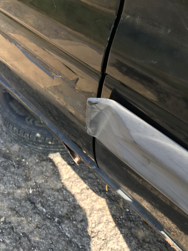

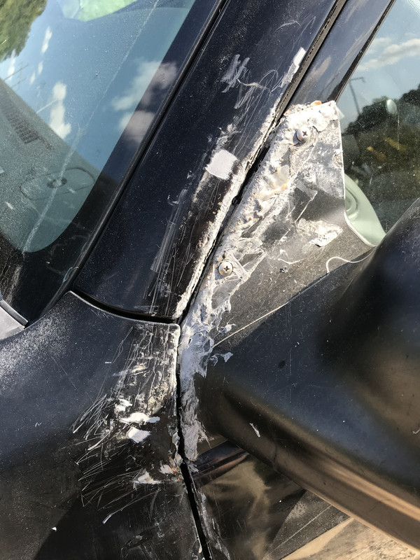

#14 · (Edited)
The trim was hitting the door and had been bent back enough that it took shape. Trim was about half falling off in several places, so I decided to remove it, it'll just get ripped off in the woods anyways as soon as a briar/limb gets under it. I'll spray paint the scuffs. The body is about 3 colors of black already.
If anyone wants this trim, I'd be glad to offer it for free, just pay shipping.

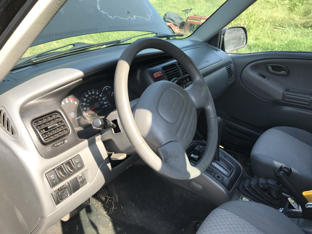

The interior is not bad, just a little dirty.
I hate the radio. It beeps whenever I turn the car off. I don't listen to the radio much anyways. Not sure how... but I will do something to remedy that beeping. I'd rather have a storage spot than tunes. Anyone know what that hole in the console might have been for? There are some holes in the roof rack that makes me think it had a light bar at one time.
Just sweep the dirt over to the hole.

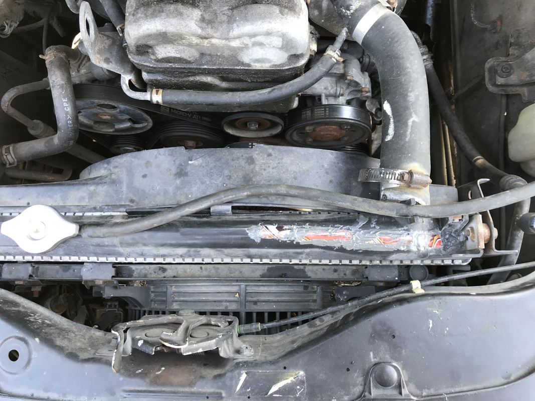

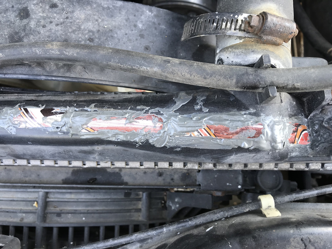

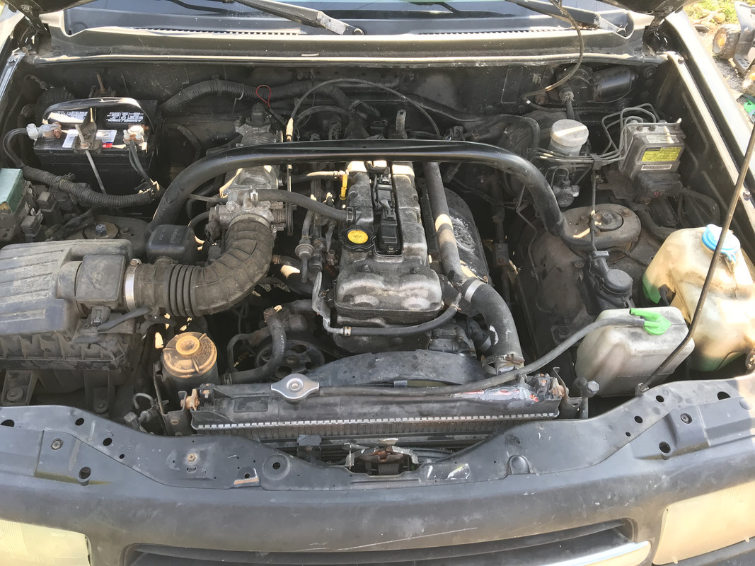

The other day my van broke down. The transmission popped and it wouldn't move. I was 2 miles from home. I hadn't driven the Tracker in a while on the road, just in the yard. So I took it up the road towards the van. I noticed it had a severe loss of power, and when I got there, I saw that the caliper was locked. It appeared to have released some so I attempted to tow the van. I successfully towed the van, but when I got home, the radiator exploded. It appears someone had put stop leak in the coolant system and that had clogged up the overflow opening.
Since this was easy to get to, I repaired it with JBweld. I v-grooved the crack with my dremel, then roughed up the surface/deburred with sandpaper. Then I cleaned it with alcohol. I made small patches out of aluminum can, roughening them on the underside. I applied the JBweld to the crack, then applied the patches.
I test drove the car 1/4 mile up the Y that we're close to, and it got up to temperature quick which is abnormal for this car, as it's normally cold natured. So... I'll venture a guess that the stop-leak has clogged my thermostat. I had a pinhole leak in the repair.
After it cooled I dremelled into the pinhole and applied JBweld and tin can material over that spot. The next day I drove it to the Y and it came up to temperature and I had no leaks.
I've repaired a smaller amount of damage in a plastic radiator once before with JBwld, and that held, so I expect this to hold. Anyone want to comment on if this repair will hold up over time or if I should be expecting it to fail any time?
Here is my repair to the radiator.
#17 ·

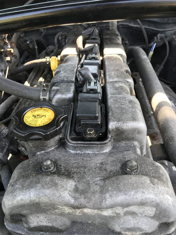

Coil packs first - generally speaking, they are replaced if/when they fail - that said - the lower part of the coil pack that connects to the spark plug can be replaced separately, and in my opinion, should. It should be treated as if it was a short spark plug lead.
Which hole in the console? The one alongside the shifter? That didn't leave the factory like that, so we can only guess.
JBWeld and the radiator top tank - in my experience, it doesn't hold for long.
#18 ·
Thank you for the coil pack info. That boot between the coil pack and plug looked to be in good condition, no rust and so forth. They are available separately, and at about $7, so I will consider changing them when I change the plugs.
Yes, the hole next to the shifter is what I was referring to.
As to the radiator repair. I wonder how long I can get?
On the underneath side of the coil pack, where the spring goes up into it, there is a screw that the spark comes from. It's rusty. Is this of concern?

I do have a praise report! After I towed the van home and the radiator blew I moved the Tracker maybe 30 yards and parked it. I let it cool a while then I washed the motor/under the hood off with water via a 5 gallon bucket. Then I repaired the radiator as shown over the next couple days. When I started it, it was missing something awful. I thought I had a blown head gasket. After a couple days I decided to inspect the plugs/coil packs. I had to look up where the plugs were as I'm not used to this kind of motor, I've always had push rod motors.
When I took No. 1 plug out I seen 2" of water standing in the hole. I knew right then I didn't have a blown head gasket, and I praise God for it.
I removed and dried all the coil packs, their boots, and the plugs. When I reassembled it all, she fired up and runs good. None of the plugs were fowled with oil, though 2 appear to have had a small amount of oil on them, but their holes were not filled with oil thankfully.
The plugs have some visible wear and will be replaced. They are NGK brand.

#21 ·
It can fail the next minute or stay like that for ten years, who knows. You should definitely prepare for it to fail anytime. My personal guess is it will fail after 2000 miles.
Easiest option might be to replace the whole door. I see two black Trackers, 2003 and 2004, at Jay's Auto Recycling in Sparta, KY, with rear doors listed for sale. They don't name a price but I saw other doors for $150.
#22 ·
