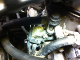

Wait...isn't the IAC part of the throttle body on my 1992? It doesn't just disconnect. I have no wires going into the IAC, unless I've misidentified the IAC on my vehicle? I am new to Zuks but see the pics below and tell me this isn't the IAC for my specific year vehicle:
The only wires I see here are the six in the connector in the last pic: two for the injector and four for the TPS.

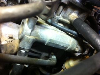

#13 ·
This image is of the IAC installed in the original location by the PCV. The top nipple that is broken off is for the hose that goes to the big vacuum line at the base of the throttle body.
The IAC in this image is right above the thermostat housing with the to 5/16 hoses coming from it. The black cap on the IAC is part of my fix for the broken nipple. Had to move the IAC when I put the 1.6L intake manifold on as the IAC bracket did not just bolt on.
