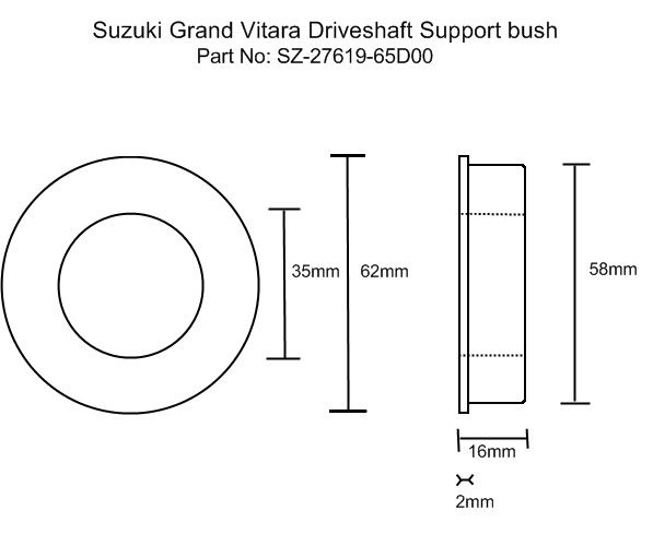

My local suzuki dealer quoted 2.2 hours at $75/hour, $29 for a new seal, and $79 for an updated bushing that prevents all the play which wrecks the seal.
Hi Ian - do you have any further information on this bushing? A Part number or similar would be great - as I was thinking it may be a solution for the leak I have - but all the info I found was that I had to replace the diff as there was no off the shelf fix?

Thanks Ian - appreciate that - I'll start chasing up Suzuki Australia and see if they can supply the same part here....fingers crossed they will be able to supply them - otherwise I'll be buying one online somewhere I guess and getting it shipped back here...

OK - have been able to locate the part - thru Keema Cars (they are the Suzuki dealers in my area) - they have it in stock in the local warehouse although they didn't have it in their system to start with, Retail price is AUD$104.40, and AUD$22.60 for the seal.
So I'm off to order that after work tonight and will update on how it performs on a more severe case of movement........
#15 ·
Bush now fitted
Fitted the bush on sat along with a new seal - pleased to report that there is now next to no play in the CV (better than when we bought the car at 116,000km) and there is no more leak :D

Its not a bad job to do yourself - but time consuming - if you have a look in the online manual - it outlines it, you basicly need to unbolt the hub from the suspension to allow you to pull the CV out of the diff - in my case, I was unable to release the bottom ball joint, so ended up removing the entire lower wishbone, and the strut assembly with the brake disc and driveshaft attached. Once you have access to the diff - you remove the old seal, slide in this nylon support bush, and install the new seal - takes about 2 minutes at the most.

The bushing is a good, cheap fix but should be fitted from new.

I'm new to the forum. My '01 XL7 has developed the leak in the right side diff oil seal. I've purchased the new oil seal and the driveshaft support bushing. I've also purchased a new cv halfshaft and noticed that the compressed length is about 3/32" longer than a remanufactured cv halfshaft. Because of this increased length, is it necessary to use the support bushing?
