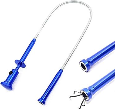

Thanks for the reply, I was thinking about trying something similar to your advice. I might not have to if what I'm doing right now works I'm trying too fish it out with a couple of coat hangers. I have a buddy that coming by to lend a hand he has one of those scopes you attach to your cell phone l'm hoping that will help once I can see what I'm doing.
I had planned on pulling the motor and transmission this summer to do some rust repairs and paint . Im just not up too it now especially since I just put a clutch in a week and a half ago, I'm still sore from that,lol. I have to keep this car on the road while I rebuild the E40D that goes in my van.
Mines fancier, has an led at the end with the claws, very handy at times

Thanks, I have one like aquanaut20's picture it's been hanging on my garage peg board I didn't keep it lubed so it rusted and siezed. I got 2 new ones, they will be here in the morning . The parts stores carry them but there low grade like my old one I upgraded and will stored them inside. Lol, definitely, that's how I got burned while taking it apart. I need to check the FSM and see what they recommend. I noticed some oil in linkage area also I had ment to find out if it should be dry or not

not sure whoever proposed these tools have faced the same problem.... how on earth those grippers are going to get around the 90 degree neck of the shifter is beyond me...... i''d say im pretty handy with mc givering solutions but seeing how it looked like, didnt even try...
if that plastic piece ended up at the far end of the shifter cover jamming the shift rods, the only solution i could see was taking off the whole cover and opening the tin lid on the under side.
so good luck with your coat hanger/gripper hunting, maybe in your case the part decided to stay close to the shifteer hole and it will be easy to fish

Ok, I need to thank everyone especially Turboguzzi who told me to "Think" . My new tools from amazon were already at my door when I went outside at 7am this morning .
