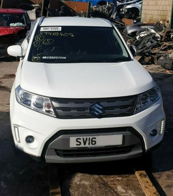

I'd be tempted to say yes the socket has probs gone belly up, but that's daylight robbery for a new one. Maybe worth taking a punt on getting one from a breakers for a more sensible price.
Bit of a dilemma as you'd get a better guarantee on a brand new one, but have had your pants down on the price in the process - maybe a breaker will offer guarantee against dead-on-arrival?
Try messaging these sellers that are breaking Vitara LY for parts
