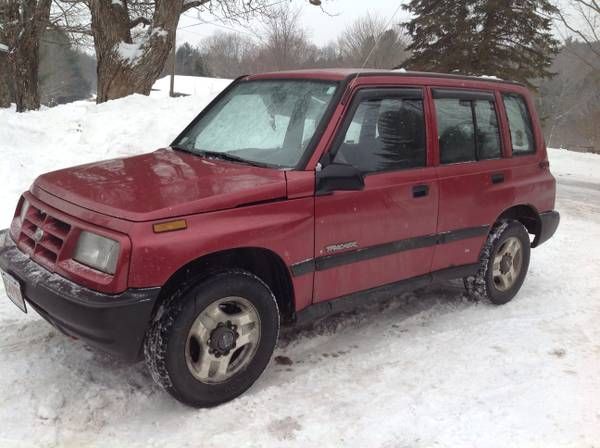

New to the forum and just bought a 97 Geo Tracker (4 door, 4x4, 16V engine, Auto) and i'm looking to do a "new" vehicle tune-up, figured this is a good place to start. I know the typical things like oil/filter, spark plugs, wires that look iffy, fluid top off, check diff/trans/t-case fluids, air filter. Is there anything beyond normal tune-up procedure that i should look for/replace? This truck will end up being my DD until my other truck is complete in a few months (Street legal Ford Ranger pre-runner build). after that i plan on lifting the Tracker and doing bad things to it... haha ;)
This is the Tracker
