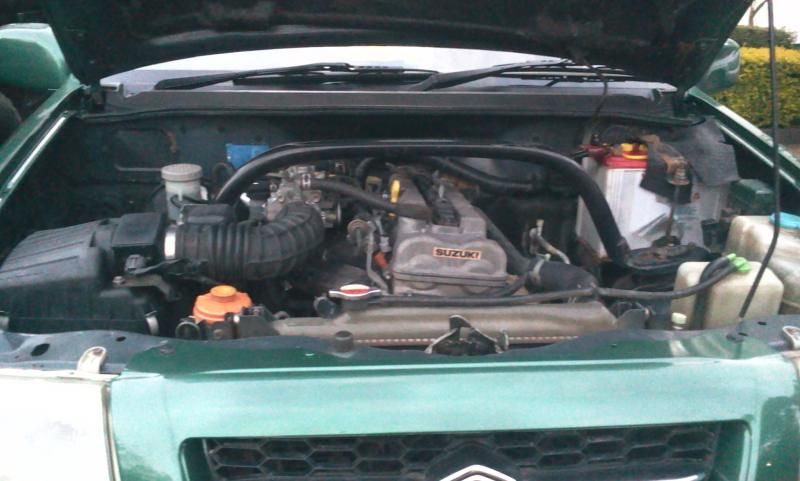

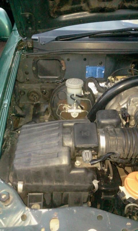

hi, I have a Grand Vitara 1999 (just like Max's only green) 4WD. We had an accident with it recently while on holidays and it was fixed up at a local garage so we could get back home. But now we noticed an empty space near the engine and no one here (Nairobi) seems to know what is supposed to be there. here are the photo's:
Any ideas are appreciated.

Hmmm. Right hand drive, huh.
Just where is the location in question of this missing part, in your pics? :huh:

Are you certain you're missing something? Here are some pictures of RHD Grand Vitaras of 1998-2000 vintage with the 2.0l 4cyl engine (which yours appears to have fitted.) Excuse the upside down picture- that's how it has been posted on the internet.

Nirrod. Are you referring to what looks (to me) as an add-on welded bracket here? :huh:
Comparing it to:

If the vehicle has ABS, the modulator will be in that location - if there is no ABS it will be empty.
It's unlikely that anyone removed the ABS modulator as it would require re-plumbing on the brake piping which would be difficult to accomplish with leaving visible signs.

Thank you so much for your replies. The car doesn't have an ABS so that would explain the empty space.
Possibly my impression of there being something before comes from the damage to the metal parts as a result of radiator acid leaking out when the car was upside down.
