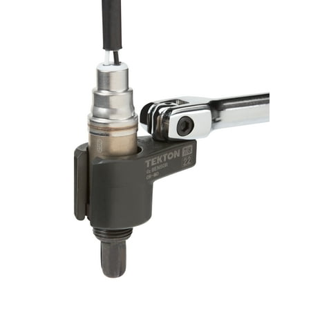

The must have tools...22mm sensor socket and flex head wrench. ;)

PS: I bought the tools recommended.
