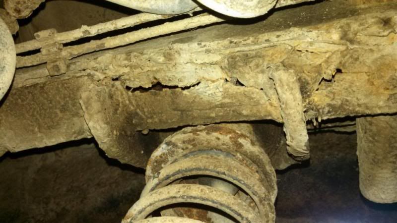

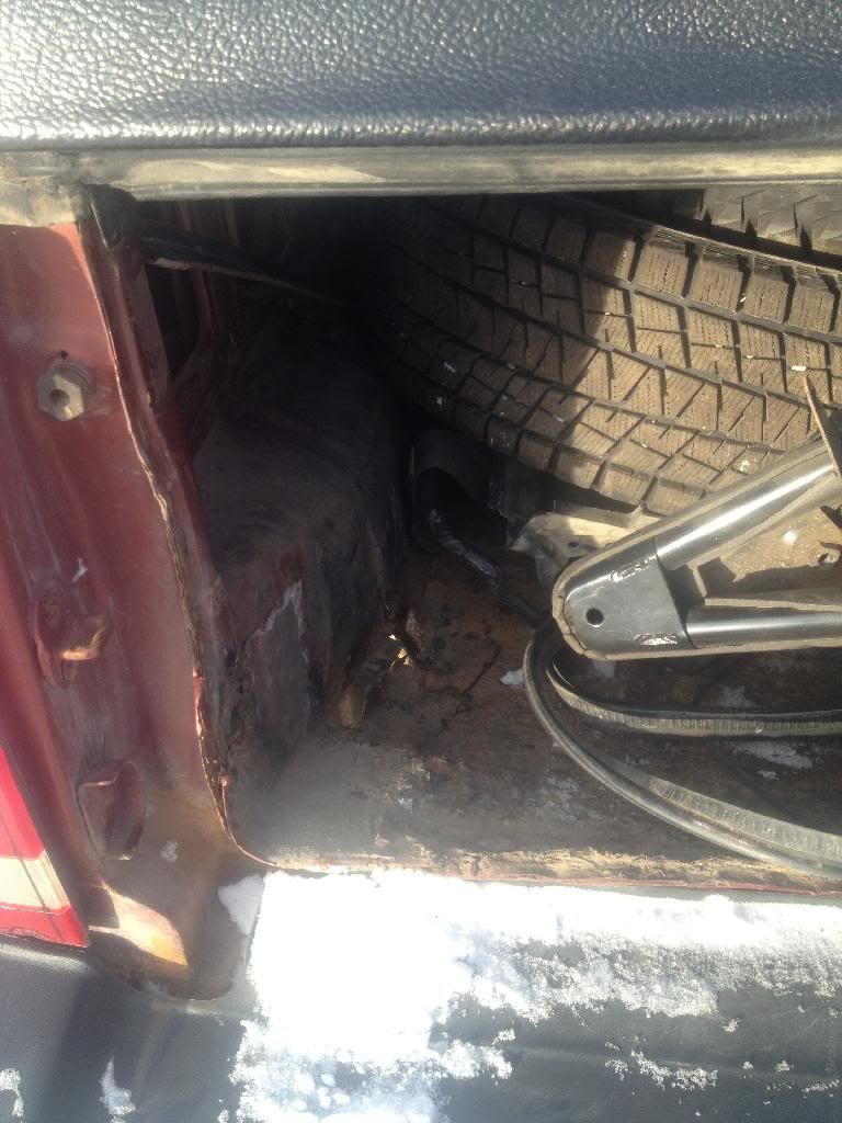

So i purchased this 1992 tracker without seeing it since i was away for work (i know stupid) but i sent 2 of my friends (one is a licence auto body man and the other is a backyard mechanic) well when they went and saw it they told me that it was in good shape and that the only thing it needed was the rear floor pan fixed. Well come to find out yesterday that the frame is rotten in 2 places, it needs a whole new front end (ball joints,tie rods, swaybar links) , brakes all 4 , u joints and axles .Thing is i already spent 1400$ for a calmini lift kit and 800$ for tires. I was wondering if anyone had any luck welding this portion of the frame.
The outside is really clean and i would love to get it fixed, but i don't know if it will even pass inspection?

Here are some more pics:

I've had my frame welded there - near rear suspension/wheel well, right? (and some other places, as well). Rust is an issue with these cars, and possibly you might not have bought it if you saw this. I have owned my car for 18 years now, and just keep repairing it. It's a great, dependable little truck that sadly has lived in the rust belt all its life. Everything is doable, of course, if you have the inclination to do so. The truck looks like it already has a lift on it, by the way, from the photos. Or else incredibly teeny weeny tires. Personally, I would have thrown my money into making sure the car ran well, tune up, maintenance, etc., before thinking about the lift and tires. But that's just me.....

Well i didn't know about all the problems before i ordered the lift kit and stuff, yes it already has a lift on it but its just spacers and i wanted a proper suspension lift. Glade to know you've had success fixing it :)

Wouldnt be terribly had to cut out the bad portion, cut some plates, weld them in and grind smooth.
If you did that and implement paint the frame...it would take a very very sharp eyed inspector to notice it at all.
993 Posts
Not a big deal to have the frame welded have it done right if this is a driver you will need it to pass inspection. There are lots of trackers and sidekicks on kijiji so you may find a parts car to rob frame pieces from or better yet use new metal. You want the repairs to be safe, I have had a couple in here that they put bondo and rockguard over the rust.
