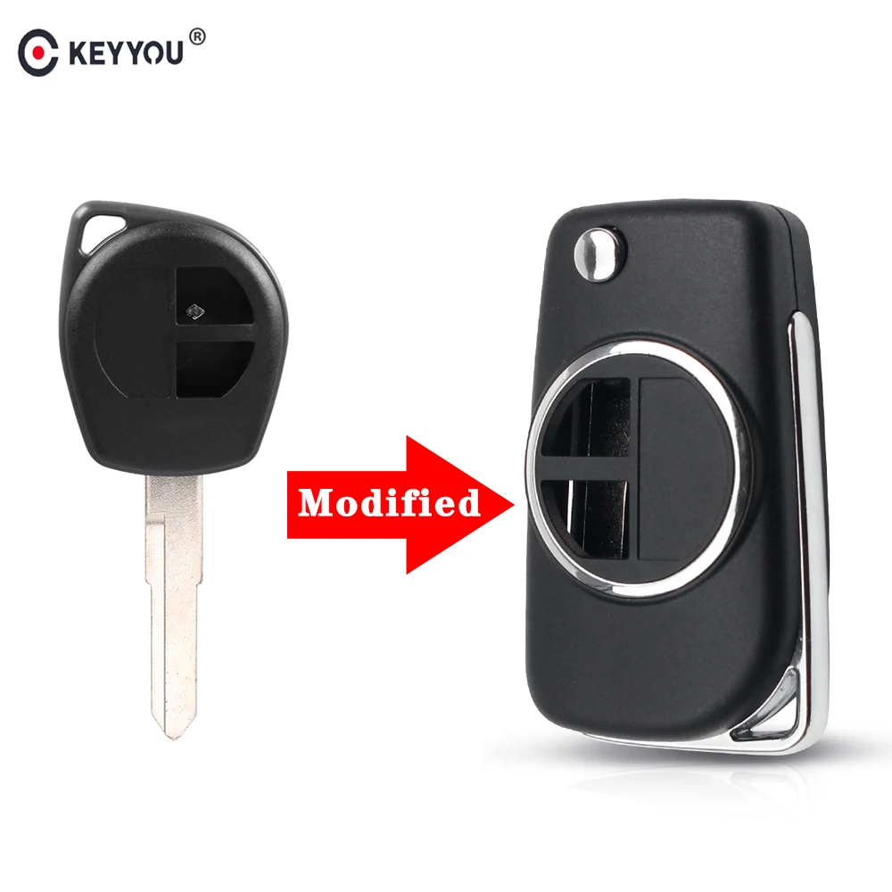

I have two keys for the car but surprised they are not flip keys.
Does anyone know, if it is easy to change in to a flip, I would only do one of them.
I had a look on the net but seemed very complicated
374 Posts
I suspect the problem will be in the immobiliser chip that’s located in the fob. You’d need to find that and transfer it to the new case.
Timpsons May be worth a try.
It is an absolute doddle.
1. Buy flip key from Ali Express (delivery was 10 days using Ali Standard shipping option)
2. Get blade in New flip key cut at Timpson (copied from existing keys)
3. Take screw out of back cover of existing key
4. Pop electronic module out ( single piece so won't fall apart)
5. Take back cover off flip key
6. Put module from old key inside
7. Put back cover back on flip key and fit the 2 supplied screws
8. Put logo sticker over screw heads on back of flip key
9. Go drive Vitara
(If you have any question about the key blade type to fit Vitara ignition you need one with HU133R)
There are a couple of styles of flip key, at least one causes issues because the immobiliser chip is placed too far away from receiver in ignition barrel.
Get the same style as the one in the link below and you will be fine - did the swap in one of my keys a few weeks back (bought from the seller linked below)
If you buy from a different seller check that you get the 'S' logo sticker for the back as not all come with them, usually says in the description.
Video guide (not English language but you only need to see the pictures - it's so easy)

long story but getting a new Vitara next week. Yes I had one last year, but things, life, work all were weird, as for most people, and I did stupid things re cars. anyway, I have ordered the flip key via your link, so thank you.
