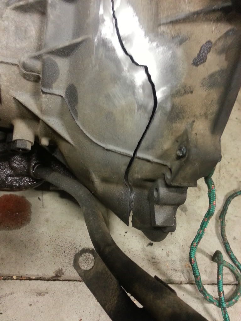

The F-150 that these came out of was BEAT, and the transmission crossmember was almost torn out of it. The problem is, that when we got it all out, the transmission bell had a monster crack in it. Good news is that I tried TIG welding a sample of the trans, and it welds nicely. so ill see what I can do to put humpty dumpty back together again.

Made a bunch of progress today. Got the intake manifold on, and the transmission endbell welded up really well.
