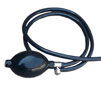

I shove the shifter into 4H, then squeeze the bulb to engage. To disengage, I twist the pressure release valve on the bulb, then shift to 2H.
It's not as convenient as stock, but it is way more dependable, with less mechanical, electrical and moving parts to go bad. And you don't have to stop and get out to lock-up!
