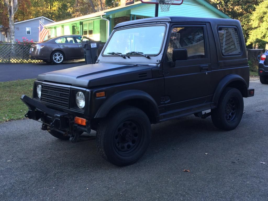

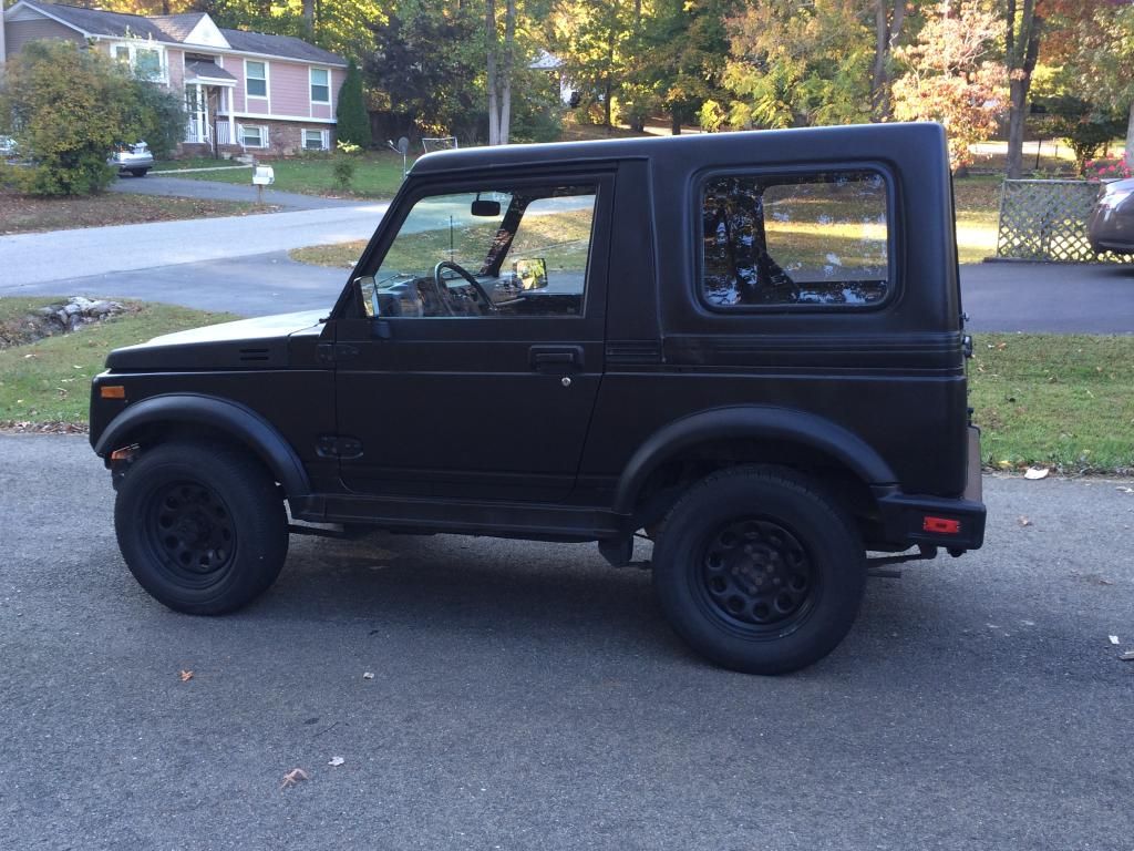

Hey guys. I just recently traded my 99 Jeep XJ for a 1987 Samurai. This is my third samurai and its for the most part in good condition but it's stock. I want to do the obvious mods; lift, tires, etc. I'm not building a rock crawler just something that looks cooler than stock 205 tires! I want either 235/75 or 29x9.5 tires. The front bumper is gone and the previous owner made a stinger style bumper for it. I'm looking at a simple 2" shackle lift and am wondering what else may be required for the lift? BUDGET BUDGET BUDGET! I'm not spending over $100 for the lift. Will I need extended brake lines and shocks? Again will I NEED those things? It won't spend a lot of time off road either just mostly zipping around town.
Thanks.
