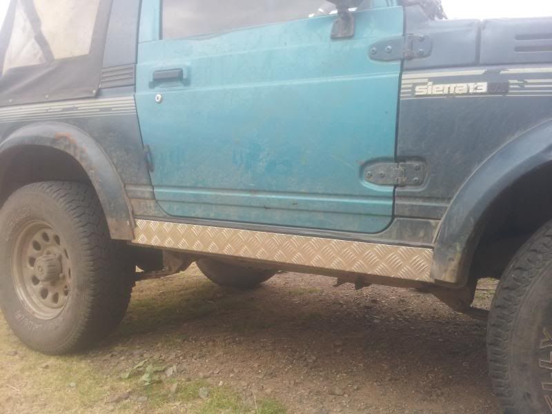

just finished doing that
cut the outer sills out with angel grinder at spot welds, inspect the rust damage
attack rust , and their will be some
next any metal, i got the aluminum check plate off ebay for 60$
bent and shaped up for me , Any body with a metal bender could do it for you , the lip going under the car is less then a inch long and is a simple 90deg bend
My drivers side looked that good after a some bog a sand and some paint. i wish i had done it ages ago and not worried so much about the pop in bits , get in and attack the rust

Did same on my Sami Put some tar like moisture barrier
on the rocker then fitted the aluminum with pop rivets.
Rides over rocks and logs like sliders. Haven't bent them
yet.
