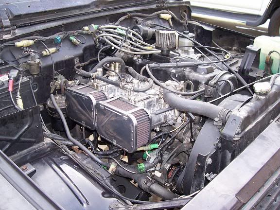

If you have a properly tuned stock carb on a stock samurai, then it will get better mileage than the CV carb. The CV carb will give you more volume of fuel/air mixture so if you couple it with a header and larger exhaust, you will get a considerable increase in power. On the downside, The CV carb is not regulated with an O2 sensor. They are very efficient when properly jetted, and if you drive a specific way you won't need to rejet them. They will need to be rejetted for different driving styles/conditions and altitudes however. I had twin dual mikuni side draft carbs on my rig and they were jetted for sea level highway use. I ran them for 8 years. The additional power was great but it did wear on the engine more and I did go through a couple U-joints and a motor mount.
After 4 years, I was starting to get blow-by pressure build up in the crank case. It gradually got worse over the following 4 years untill it was venting out the dip stick and PCV valve. Last year I took them off and went back to the stock carb so that I could preserve my engine. I just didn't have the budget at the time for a rebuild or replacement and didn't want to push my 160K mile engine.
