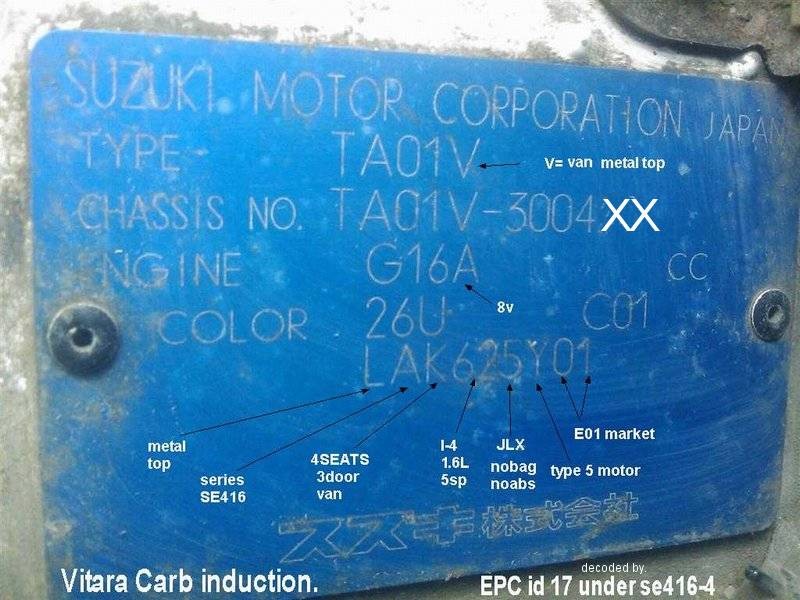

ill take a wild guess, your tag looks like this.
all info you need is here.
totally not like USA or canada cars.
its has his.
right?
here is a very unique car , that is missing many common ECU parts.
one of vast variations of VITS world wide. not posting location,. makes it hard.
not posting tag data harder.
can i ask if the data on the tag is more complex that the below?
especially other long codes a the end?
give good input, and output can go far better,,,,, i promise.
where do you live.
and be aware, your car can be made up of ,many wrong parts. so we can discover all that if want and are serious in making it all play together , like day one.
or more verbose like this>?
one step at a time, and guessing about what's under hood is dumb.
here are the ropes: (in a real shop we look then leap. we identify the car, then find wrong parts on car or hacked parts.. then we correct that and then fix the other issues) in that order.
1: what country?
2: what vin, got it . Its not a cami car, its Awata car.
3: what tag data. (at the bottom are some very good facts) see last photo above for that idea.

XXX Thanks for the link. couldnt pull it up on my android phone last night but works on my computer. My location is Mississippi USA and the car is LHD.
id be all over 53s, like white on rice. its bad to the bone that code, I LOVE IT!!! im concerned too!!
running rich, engine missing, little to no power-timing2.jpg   running rich, engine missing, little to no power-timing.jpg

Old 01-18-2013, 07:31 AM   #10 (permalink)
Bex
Veteran
Bex's Avatar
Join Date: Mar 2008
Location: Ireland
Posts: 13,314
Bex is on a distinguished road
Yes, the timing can be out, and the car still running. And your timing IS out, as you're compression is around 120 on all your cylinders. If it was just one cylinder, then it is a different story. But if all of them are low like that, you need to sort out your timing before anything else. Look at the link under XXX's signature for his journal, and read how the timing should be done on these cars. You should be getting at least 170psi on all cylinders, on a warm engine, with the test done WOT. It is kind of senseless to diagnose any problem until you know for sure that your timing is spot on. Timing affects everything.
Your ECU is for a California car. (33920 56B30 for federal, 58B30 for California). Now look at the sticker under your hood, and look to see if there is ANY indication of California anywhere (normally will say something like car adheres to California emissions or federal emissions). If it does not say California in the emission statement, then you are running the wrong ECU on your car, which is why you are getting the code 53. The ECU is looking for a separate ground that only California ECU's have.
