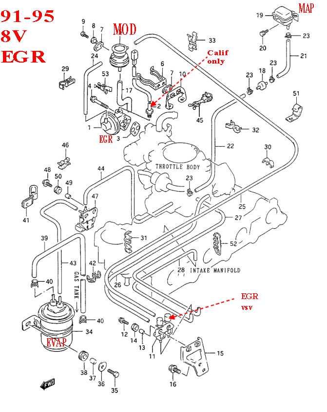

Head is back on and cam timed, with valves lashed. All is buttoned up except waiting on dizzy O-rings so I can install and time it. Did a compression test and all values are between 168-175 psi cold. Hopefully I can fire it up tomorrow and move on to diagnosing the possible fried ECM (light still comes on with key).
I did end up with a missing hose, going to look at some diagrams here in a minute. Didnt get too worried about it as I had other things to worry about getting done before I had to stop for the day. Here is a pic of said missing line, or where it should go.
Sorry about the picture format. For some reason my computer is being horribly stupid and will not allow me to upload anything. The nipple right there above the brown connector is what I'm talking about. Right side of motor, below intake man., you can see altenator in background.
EDIT: According to this diagram (http://www.fixkick.com/sensors/EGR/92-95-8V-EGR1.jpg) it goes to canister. I know I looked and saw both hoses on top of the canister, but I didnt trace them. Guess it probably just hanging down waiting to be reconnected. Times like this I wish I could just walk outside and look lol.

that is evap
the cans have on some 3 nipples
one is just and air vent (bottom)
on to tank vent
and one to vsv evap valve nipple.
