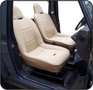

As far as Suzuki suspensions are concerned, you already have a decent setup (coily). I would look into a better seat solution to smooth out the bumps. Here is one from Spidertrax built to bolt into a sammy.
PRP Combo Seat Kit

I whole-heartedly agree with Bill-John...The seats make a huge difference.....been from Calgary to Key West in my Sammy and my bum is still talking to me....as well I keep my tyres at 24 pounds and the ride is better and tyre wear less....Lastly....a better quality shock absorber is worth the price....
